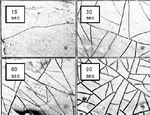

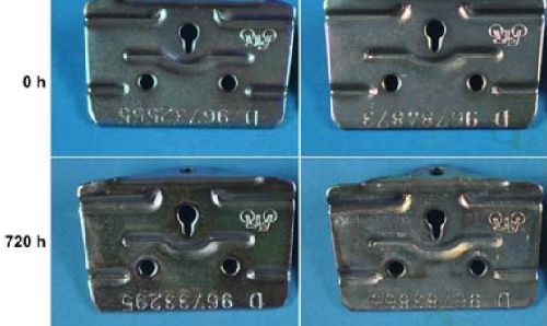

Impact on the conversion layers for zinc and aluminum. Chromate and dichromate salts have been and are still used in the conversion layers on top of zinc, zinc alloys, cadmium and aluminum. The oxidizing properties of hexavalent chromium act to oxidize the substrate. The subsequent pH increase at the interface favors the precipitation of zinc and chromium hydroxides and oxides, creating a gel-like structure which upon drying will form a micro-cracked layer with major anticorrosion properties (Fig. 5).
Figure 5 - Microcracked network formation of a Cr(VI) converstion layer on Zn/Fe vs. drying time.4
Figure 6 - Conversion treatment on aluminum* (L) and with optimized process (R).
*Lanthane 613.3, Coventya Holding SAS.

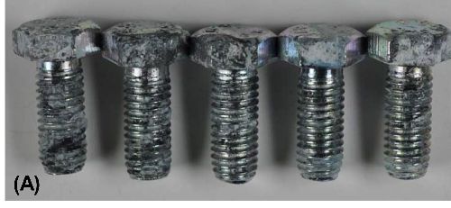

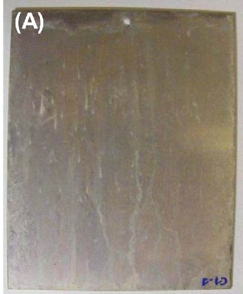

The Cr(III) conversion layers on zinc and zinc alloys contain a significant amount of cobalt salts. Cobalt acts as a catalyst to regulate the kinetics of conversion layer growth, but it is also incorporated into the layer, thus participating in the inhibition of corrosion.6 As described above, Co(II) salts are subject to the authorization process under REACH. The removal of cobalt from the conversion solutions results in a major loss of corrosion resistance as seen in Fig. 7.
Figure 7 - Appearance of (A) cobalt-free and (B) cobalt-containing passivates on pure zinc after 72 hr of neutral salt spray.
Co(II) salts are then progressively substituted by alternative, non-hazardous elements that are also incorporated in the layers. The incorporation of these elements enabled the same or enhanced Cr(III) layer weights to be achieved (Table 3), ensuring proper corrosion resistance of the system (Figs. 8 and 9).
