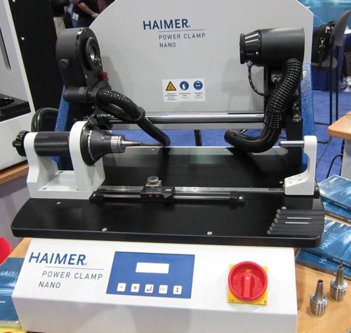

A Different Type of Shrink-Fit Machine for Micro Work
Horizontal orientation is a distinguishing design element of this compact new shrink-fit machine.
Toolholders with HSK interfaces are said to be the best option for micromachining applications. That’s primarily because the toolholder’s hollow-shank design enables its taper to maintain full contact with the spindle as the spindle expands, while a consistent Z-axis tool length is maintained via the face contact provided by the toolholder. Haimer has developed a new oriented shrink-fit machine to speed and simplify cutter changes using these toolholders. Unlike most, this device is horizontally oriented.
