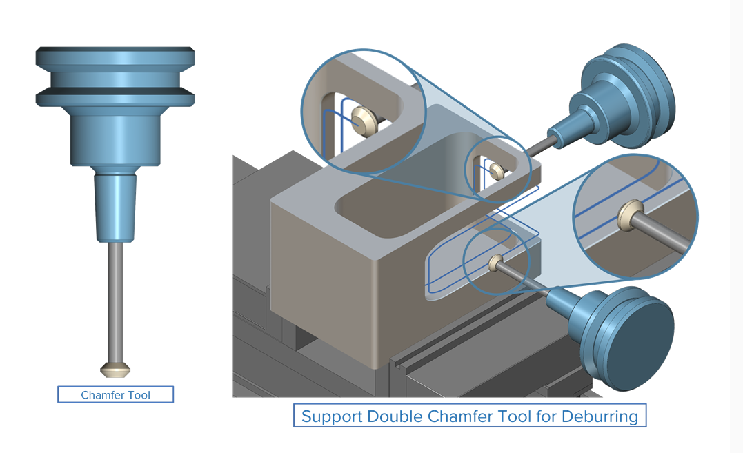

With double chamfer tools, both the upper and lower edges can now be deburred in a single operation, as the system automatically selects the appropriate chamfer for each contour. Source: ModuleWorks

Deburring operations have also received an upgrade in ModuleWorks.
Previously, deburring required separate operations and two different tools to process the top and underside edges of a part, increasing programming and machining time. With double chamfer tools, both the upper and lower edges can now be deburred in a single operation, as the system automatically selects the appropriate chamfer for each contour. This streamlines the machining process and significantly reduces programming time.
