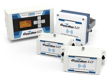

The Vektek Guardian 1.0 momentary pressure monitoring system consists of three components: a master control unit (top-left), a fixture transfer unit (the two lower devices) mounted on palletized fixtures and a machine tool receiver (top-right) that uses Focus Field technology to communicate with fixture transmitter units. Image courtesy of Vektek.

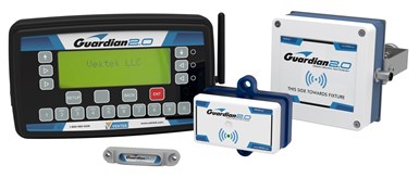

Vektek’s Guardian 2.0 continuous pressure monitoring system has wirelessly paired master control units (top-left) and fixture transmitter units (middle), as well as pallet ID tags (bottom) affixed to individual fixtures and a pallet ID reader (top-right) inside the cutting envelope to determine active pallets. Image courtesy of Vektek.

Momentary systems, such as the company’s Guardian 1.0 system, are a bit simpler to set up. Roth recommends his company’s version of this system for load stations and pallet staging areas (while acknowledging that they can work elsewhere), and notes that the user side of the system does not need to be complicated. After setting up data collection units on palletized fixtures and an RFID reader for these systems, the control unit only needs power wires and an alarm wire. Roth himself calls it “a really fancy light switch,” off when pressure is normal and energized when pressure readings are abnormal. The alarm wire can activate one of several alarm responses, the most common of which Roth says are M-codes to stop a machine, E-stop shutdown commands, and visual and audible alarms.
These same alarm responses apply to continuous pressure monitoring systems like Vektek’s Guardian 2.0 system. These systems work best when measuring inside the machine tool, which requires more flexibility than momentary monitoring systems. Vektek’s take on continuous systems uses tags equipped with wireless signals, which enable users to distinguish between them, as well as a device inside the machining envelope to tell the system which fixture needs to be at its pressure threshold or alarm out.

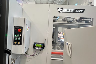

The master control unit of a Vektek Guardian 2.0 system attached to the outside of a DN Solutions LPS 5000 pallet system
Wireless, continuous pressure monitoring systems are a recent arrival on the market, Roth says. Vektek debuted the Guardian 2.0 system at IMTS 2024, and is partnering with machine tool OEMs to offer it integrated with their equipment. Image by Modern Machine Shop.
